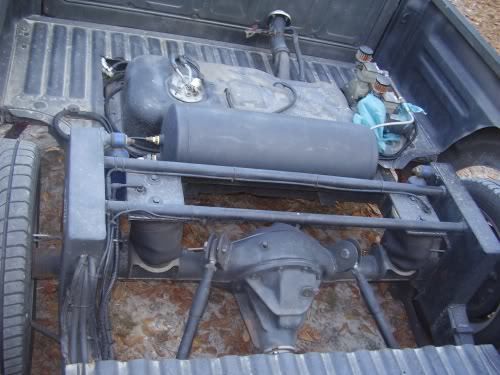

this is an old pic of my old 4link with the bags mounted on the rear 1/3 of the link bar. my lower bars are 33" long.
ha ha you can see my passenger side bag mount bent up - a sign of a beginner.
you really should let someone who knows what they're doing help you!!! that way stuff like that won't happen to you.

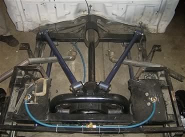

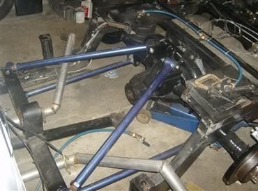

[url=]
Some construction pics, more pics at my site of it being built.
/ldc/shawn/DCP_4679.jpg
/ldc/4linkinstall/DCP_4757.sized.jpg
/ldc/shawn/DCP_4678.jpg

pinion angle is pretty bad, fix that and youre good to go.
slamditbig's avatar
slamditbig
i just set it up. thats when i just fionished it. i havent adjusted it for the road yet.
