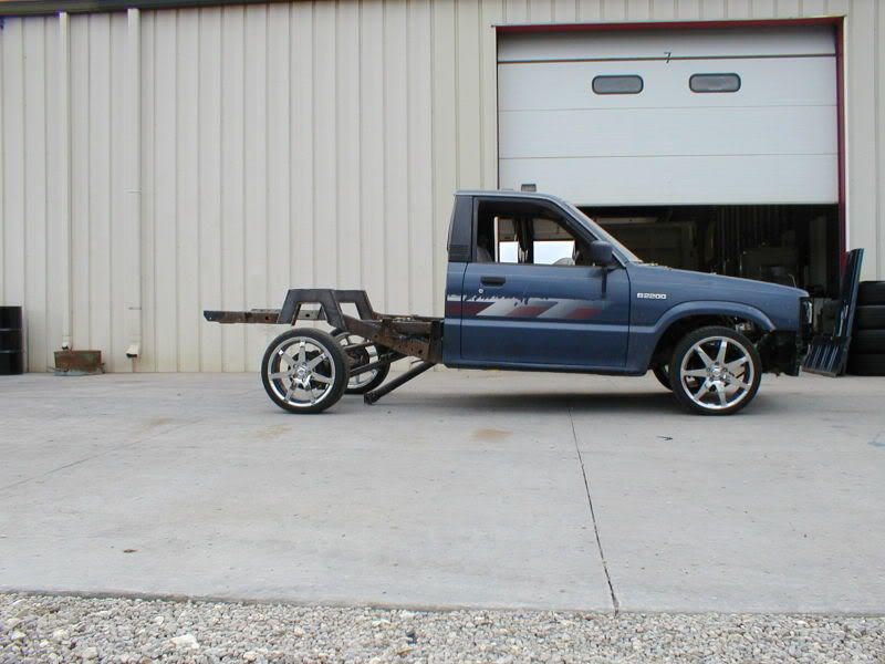

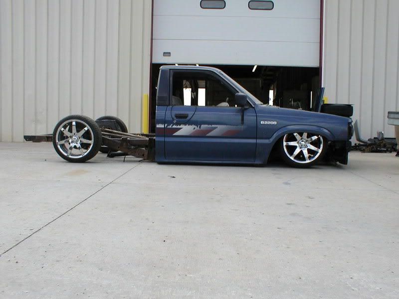

here are some pics of my truck, i am using slam bags they are the only way to go!!!! I had conitechs and the didnt lift much.. i think i am getting 10.5" of lift up front, i did notch my frame a little so i could move the bag closer to the pivot point.. but as you can see w/ my truck aired up i have plenty of clearance and that is w/ a body drop...

roknmotor which model slam bags do you have?

roknmotor
I have RE6 bags up front i think its basically a 2500# bag
