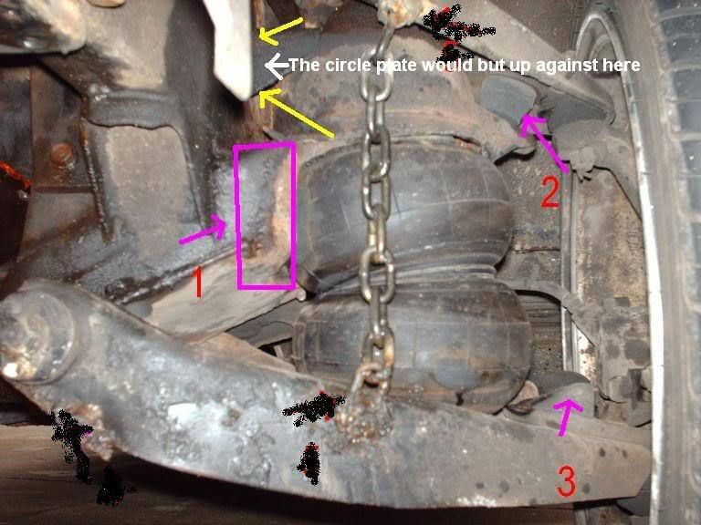

this pic is so old but it helps alot
Note this is a firestone 2500 bag.
I will see be re-doing this for other reasons
But I've been running this set up for over a year with no problems.
#1. Is were you need to notch so you wont rub.
#2. Is a Bumpstop you need to remove to lay.
#3. Is another bumpstop you have to cut out or notch so your bags wont rub them
Dont mind the chains haha, there cut away now
Were all the arrows are is were you would take a sawzall or cut off wheel and cut off the cup.

THANK YOU FRO THAT PICTURE!!
draggin84
so the cups are already there.thanks a lot for the picture.

Yes the cups are already there, No Problem on the pic. I just tooka piece of 2x4 steel tubing cut the top down to fit flush with the cup on the inside, drilled to holes for the bag to bolt down on the bottom, and welded a bolt on the top portion so It will prevent the bag from coming out of the cup.
as far as the bottom I just took a regular circle plate and cut it down to fit flush with the bottom control arm and welded it in.
