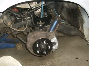

anyone have some good pics of how you relocated yours?

heres the best pic i have robbie, the bottom of the shocks just mounted to the back side of the lower control arms i just got some shock mounts from work cut a hole in the lower arms slide them through then welded and built a little gusset to keep them strong....
robbie
alright I'm gonna have to go buy me a long grade 8 bolt possibly for the lower mount the little bolt that suicidedoors gives you in their kit isnt going to come close to working. thanks for the pic

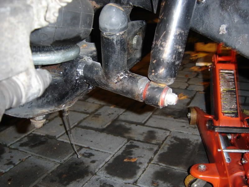

this is what mine is like.

Is that the bumpstop next to it ?
Is that the only place to mount them ?

you could mount them where ever but thats the best place i thought to put them....

why is there a bumpstop

IF YOU SUSPENSION COMPRESSES TOO MUCH, YOU'LL BUST A BAG, AND OR SHOCK.....

there would be alot of stress put on that joint supporting the bumpstop
But it seems as if its the only place to mount them
