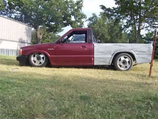

suidcidedoors torsion bar brackets, notched into the frame and welded in a piece of 8" pipe cut in half so the bag could be recessed into the frame.

got any pics
robbie
look through here.
