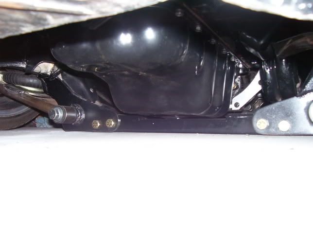

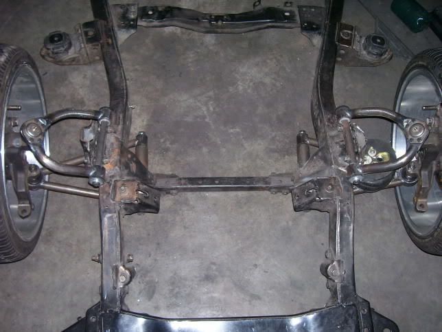

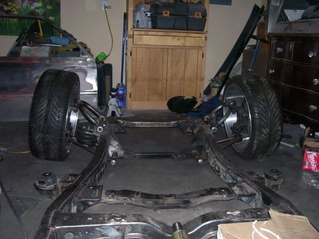

here are my cando arms what do you want to know about them
madmazda
Damn, I love that....What size are you runnin? and how much are those arms, im lookin into gettin some, thats the only way im gunna lay with 20"'s

they are mazda to toyota but im runnin mazda drop spindels all u have to do is order upper mazda arms and lower mazda to yota arms and when u get drop spendels for the mazda they come with lower balljoints and u cut the plate off of the ball joint and have the lower balljoint pressed in
and the only reason i didnt run lower mazda arms was because it looks better with press in baljoints than bolt on ones
