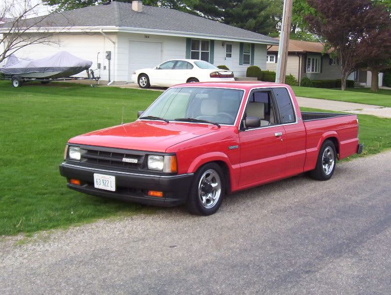

Here is my 89 b2200 and its 4 inches in the rear and four up front
crazymikey's avatar
crazymikey
damn that shits nice with a static drop! I could live with that for my truck. I still cant'e decide to go static or bagged. Static is the obvious economical choice.

1hotdawg's avatar
1hotdawg
That really is a very nice looking truck. What's the rear set up?
