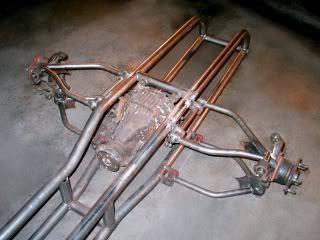

maybe like this,
a long time ago you could buy a low proflie boxed frame, I don't recall who was doin it now
bagdb2200
I don't know who makes that one, but Larry Echols at InnovativeAirSuspension.com makes a back half for RX-7 IRS to be used in different mini trucks.

This is mine.
the one that you posted a picture of is Mike Alexander's (mini truckin mag editor - Built by Aaron Iha) its for his toyota

But, truth be told, I like yours better, mad props dude!
Awsome work!
What would it cost to build a complete frame set up like that?
Would you consider selling it?
How much time do ya have into that?

thats too pretty to even put a bed on it

frame looks good corey.

That's why you cut the bed floor out

yea thats way prettier than mine.. i wish i had seen your pics before i built mine id have coppied it to a tee....i guess im more form over function...ill post some pics of my irs setup on monday

How much time into it... good question... a lot would probably be the best answer. Took me long enuff to get a good angle for the bags on the IRS, and maintain a good amount of lift.
Would I sell it... everything is always for sale... its the price that has to be right.
What would it cost... I dunno... if you paid someone to do it probably a fair amount of money... if you did it yourself... still a decent amount of money...
Southernrazed - Im glad you didn't see mine first... copying someone else's stuff is lame.

na man i wouldent have coppied it but i deffinatly would have done mine differntly.these fictures are outdated if i built mine again i wouldent pinch the frame as much as i did .i know about gettin the issue with the bag sorted out i. i ended up mouning mine in on the inboard arm of the trailing arm ..oh yea implulse wait till ya get the bill for the custom driveshaft ya better be sitting down..
