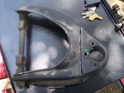

i usually just usually cut it while its on the truck, And lay it out, then takc it up, and weld it up.
baggedb22
I cut mine just like robbie cut his and we both left just enough metal on the ends to hold it together then smacked it with a hammer in not sure how many degrees he changed his but i changed mine 5 degrees and no binding problems anymore...
bagdb2200
werd...and we just pie cut the sides and fold it down then weld it back together. Not cut it off completely.

what do you need to know? that is a pic of my control arm and I have a few more of it if you want to see them.

its no big deal, if you look thru robbies thread on the Photos, its self explainatory on how he did it and he explained it well and gave detailed pics of it.
robbie
yeah my 11 page thread in the photo post forum has alot of pictures in it.
