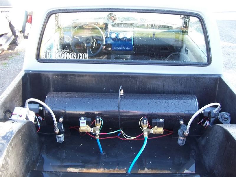

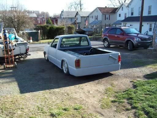

could u post some bed pics for us? thanks -bf
baggedb22
Some bed pics?? u mean like this

damn your truck is sweet
