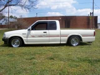

Alright... I have alot to ask! But I need to know what it takes to ride low, safely, and smart. Because I hear about mechanical drops like spindles, and blocks, etc. which I guess some of them can screw with your tread life and alignment.
So, I'm asking this, I have 4" billet blocks. The blocks are slanted, and I dunno how they are to be installed. 4" blocks or more means I have to get drop shocks. I was thinking of the toxic shocks or monroe. Which ones do I get?
How much would my suspension and handling be affected if I monoleaf my truck? I'm also concerned that my scrub line is below the rims already.
How can I tell if my front has been lowered? I think, if anything, the torsion bars have been cranked down.
I want to lower my truck as much as possible without sacrificing my tread, alignment and whatnot. What can I do?

First off...Nice truck..Really! Got a lil rust repair needed but looks good otherwise.
As for what it looks like has been done suspension wise:
You may already be monoleafed in the rear. Look at your rear leaves, count how many are there, and see if there's one thicker one yet shorter on the bottom of the leaf stack. If there's only 1 long one and one thick really short one under there then you're monoleafed. If you install the 4" blocks between the leaves and your axles, you'll be sitting all the way frame on axle lol. Only way to prevent that is 1. install another leaf, or 2. buy some airshocks and keep them aired up enough to keep your frame and axle from hitting.
Your front has definitely been lowered, most likely via twisting the front torsions.
Basically, imo, you're about as low as you can go without baggin to have some decent ride left. You might could grind off the bumpstop bracket, and/or flip your ball joints and achieve a lil more drop and lil more ride out of it...I'm asking about that in another thread to possible try on mine
