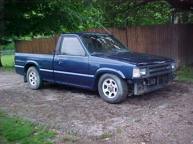

is there no way to tuck tires w/o air? i have no front suspension (torsions are off of the truck) and it tucks a lil but in the back i have 2 leafs and 3" blocks and look how high i am.
it looks gay imo. i want to be bout 1-1.5" from tuckin b/c i wana put some wider tires in the back but i donno. -bf

damn...do you float on water with those tires??? LOL i have 4" blocks and I am a hell of a lot lower than that.....im just curious what it would be like with a couple leafs pulled

i think it could haha. y dont we just brag bout it or somthin haha. im gettin lo pros....a ways down the road. -bf
