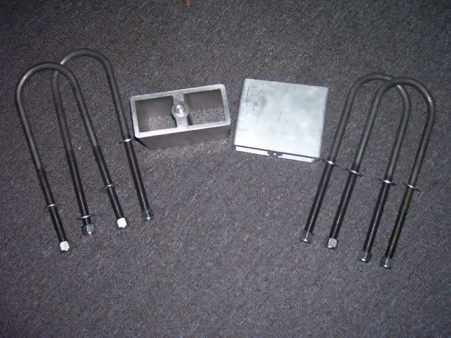

Hey guys, Finally got my 4" Drop blocks in the mail...
Whatcha think?

MAKE SURE WHEN YOU TIGHTEN THE U-BOLT TO DO SO TO SPEC'D TORQUE, RIDE AROUND FOR A FEW DAYS, THEN RE TORQUE THEM, THEY HAVE A TENDENCY TO LOOSEN UP, AND OVER TORQUEING THEM WILL BUST THE BLOCK.
SHOULD HAVE GOT THE PINION SHIMS TOO THEY WILL KEEP FROM WEARING OUT / BREAKING THE U-JOINT ON THE REAR OF THE DRIVE SHAFT.

Well i didnt get a specs sheet in the mail with the blocks on what the torque should be torqued down too. Am i torquing them down to the stock torque specs, or? can someone give me a hand here...dont wanna break them, but dont want them to fall off.

They look to be angled already
madmazda
There are angled already, I need to know 2 things, specs to torque them down too, and the angle faces which way? angled downwards to the front, right? i need to know ASAP, if someone can help me here, thanks!!

don't quote me on this, but i think that the stock torque specs for the u-bolts are 70-85 ft. lbs.

Angle faces downward towards the front of the truck. Tighten them until you are scared to tighten anymore
