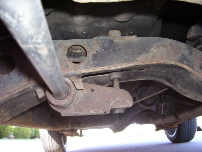

Well I Cant seem to get these to bolts undone that are underneath the truck for the torsion bars, i jacked up the truck to take all the weight off, and she didnt budge, not even with Peneration Lube, or Torch, So i dunno what to do...Im Gunna go take some pictures right now of what Im talking about just incase you's dont understand....Help?...

Here's a picture of what Bolt Im talking about...All help is appreciated.

That's you're torsion bolt, get an impact wrench or long pipe with a ratchet to crank on it .

Tried both already, its a No go....There's a "T" style bolt on top...Any other Suggestions?

I Should Be Loosening those Bolts to Take out the Torsion bars, right? Not Tightening them...

ya loosen them

lol when I raised mine back up, one side was so stuck it actually turned the "t-bolt" at the top all the way around once But it finally broke free. Penetrating lube works the best imo with a nice 1/2" pull bar.

let the oil sit there for a while then try to loosen them again............
the same thing happened to me............lol
