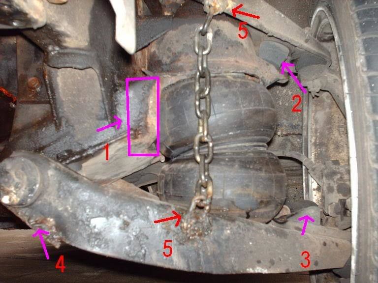

I havent moved towards the torsion set up yet but i plan on it cause im going to running a bigger wheel setup but i have 1 good current pic of my set up in the front,
this is before i notched more out of the corner so it wouldnt rub.
this was the original set up
1. you will have to take this much out if you do not want to blow 4 bags.
2. is your bump stop easy job, only 1 bolt holding it in.
3.other bump stop, i recommend a saw zaw for this, to cut it out
4. your control arms will probably look like this after a good drag but thats as far as they will go.
5. Is only good for if you want to hop the front end.
as far as what holds the bottom of the control arm, is some 3/16" steel plate that was cut to fit the bottom of the control arm, and as for the top 2x4 3/16" walled tubing cut to fit the pocket.

Cheers Slammin nice and detailed! What time you on msn usually? I'll have to compare local times to your's so we can chat!
