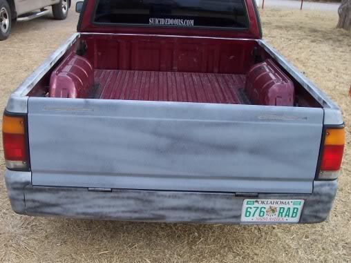

just raised my bedfloor 4" and fixing to put in a 5" notch that will lay on 19's or 20's with a small tire. everything will be mounted under the bed.
its still this deep.
://pic14.picturetrail.com/VOL505/2264144/4431855/117894998.jpg
1hotdawg's avatar
1hotdawg
Are the black painted areas where you did the cut and welding? I could deal with it being that deep
robbie
yeah thats where the two pieces met and I welded it back up.
