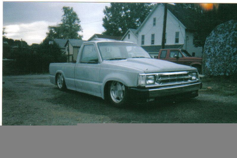

It's normally a pain to get those notches to line up. LEt the jack down a bit to get just a lil pressure on the spring, and use a mallet, (small sledge or heavy hammer), to knock the bottom plate into position. I think my right side every time is the hardest, but I get it done. Just something we have to go through
wood's avatar
wood
yo hotdawg what kind of rims u got on ur b22 stockers ....?....let me see a closeup
baggedb22
They looks to be the same wheels i have almost mine are off a chevy avalance but i have the smoothy center caps off of the chevy z-71 wheels...
wood's avatar
wood
u have to bore at all to get them to fit. .... what u do brotha
