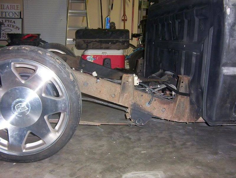

i got a 90 b26 and i removed to 2 center leafs and i just ordered 4" blocks from FBI. Will i have enough clearance over my axle with out a notch? let me know brothas. peace

You can redill the hole on the front leaf srping hanger up about 2 inches.... That will drop your back about 1.5"-2"'s.... and then you can cut the bottom of the hanger off at the frame hieght so it looks like it is gone... Just an idea besides wasting money on blocks

what place would you drill, not sure what you're talking about...
mark
its like redrilling to make your link bars higher so it wont drag
pretty much look on that spring perch and you will drill a hole towards the top/back part of the perch....leave about an inch all around the hole

i still cant picute it in my head...

A new hole is drilled higher on the leaf mount - directly above the old hole.
Now picture the hole up higher in the mount.

lol i can kinda understand,anyonehave pics of this acutally done??
throwinsparksnla
i think you should have plenty of room..just remove/cut your bumpstops. i only have 2 leafs and i have 4 inch lowering blocks and i have about an inch or more in travel..i didnt redrill anything but thas just how i did it
