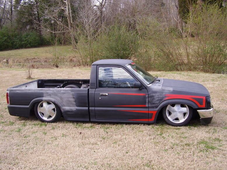

just dont drag it pass the control arm bolts lol, notice how bagman's front sits and compare it to mine...his is dragged a little bit and notice how much it tucks his 16s compared to mine
