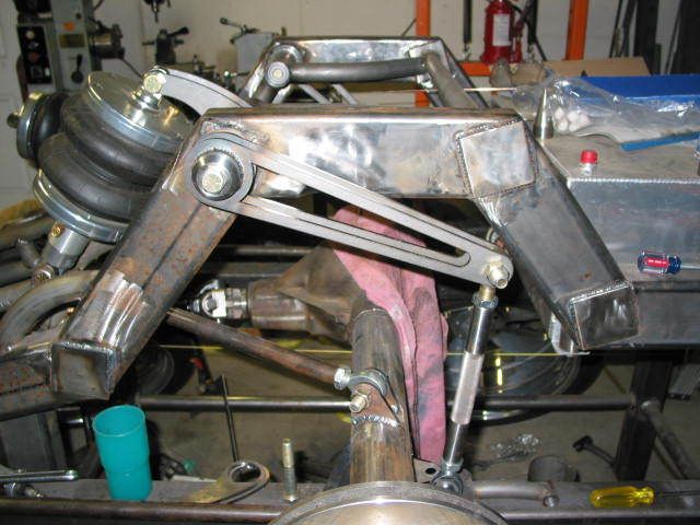

any pics of a cantilever suspension setup? i am lookin for pics.
hybrid
theres my cantilever,not a very good pic but you can kinda see how its set up with a close look

I cant tell very well from the picture, but that looks like a mechanical advantage setup, not cantilever. Is your cylinder mounted to the lower bar? THats the way mine is set up, only with bags and a lot less lift lol..
I believe he is asking about cantilevers with rockers. LIke this badass chevy. There is an axle on bearings that goes through the framerail!!
click the link

oh true canti,yeah i dont have that but non the less a lot of lift lol.

you just have a lever setup, not canty...true canty doesnt exist because its canty itself
there is one in an accord
you can do them many different ways. you asked where the pivot should be...its all UP TO YOU. there is nothing to explain since you obviously already know how it is supposed to be setup. same applies to canty's as to lever setups, the closer the pivot is to the source, then the more lift you will get, but you will sacrifice some things at the same time such as spring rate, but it'll ride soft, if that is what you want. if you want to stay in a good safe median that requires less math/etc., just mount the pivot dead in the middle of the bar, you dont really need that much lift anyway.
with that accord's setup, he can touch the rear down on a 2inch tall exhaust pipe, on 20s and clear them well with an inch or so above the fenders, full lift

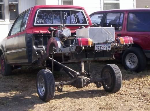

this is the accord layed out now
