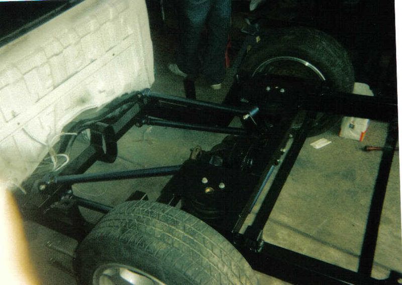

Here's a pic of my rear suspension Just make your own crossmember don't mount the lower bars where the stock front leaf spring goes u will drag 4 link bar...lol..The bars could be mounted on the outside of the frame but its alot easier to put them on the inside..Once u get it all ready to install let me no i'll give u some pointers...

ok check it out the link abouv will show you what four link i baught mine only has one baron each side for the bags to mount on and to to keep the rearend in line ...so i can run a piece of tubing across the front of the frame and mount the bars to it right do you get more lift with this ?
baggedb22
If your running a bag on bar set-up your gonna get good lift no matter what if u set it up right...Do u no how to set up a bag on bar kit?
