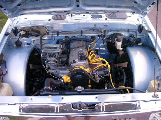

Anyone know how much of the emissions crap that can be removed from the b2200 (f2) engine? Specifically, the crap on the fenderwell.

You can remove all that crap but you will have to plug the vacuum ports on the intake manifold. When I did mine I had a box full of wires and crap I took off. There is a wire harness on the pass side firewall all you need to keep out of that is the wires for the windshield wipers. I'm not sure how to to this with a stock carb but it you have a weber it won't be hard. The only vacuum line you need it for the advance on the distributor. Heres a pic of mine

looks good.
