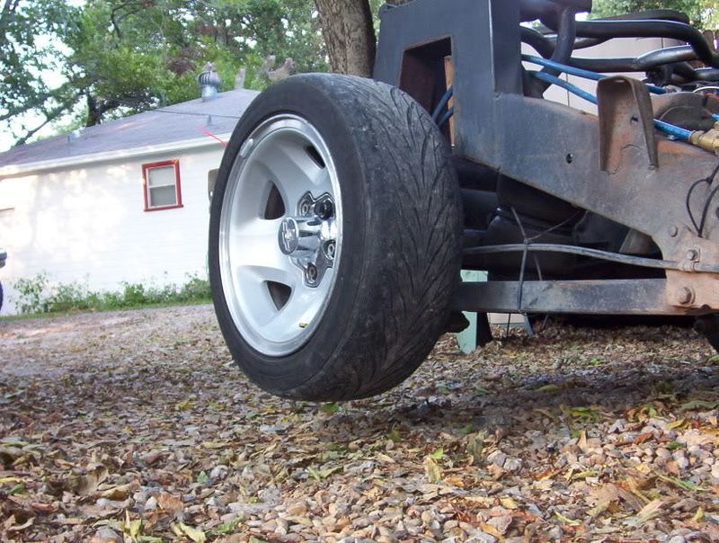

low87dawg
this is my friends 88 sdime with a 2 link and a watta link from BYC it was on gravel when i took this pic so it was only up in the air about half of what it would
low87dawg
thats him in the pic

nice! did he use a lever kit? also i was looking a suicidedoors.com
