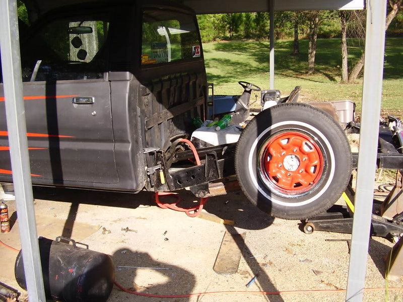

this is my first truck,good so far???

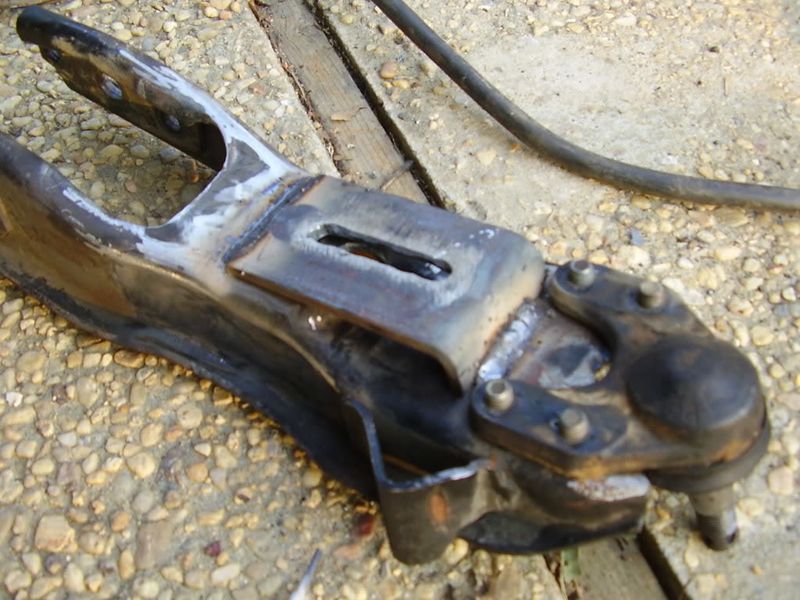

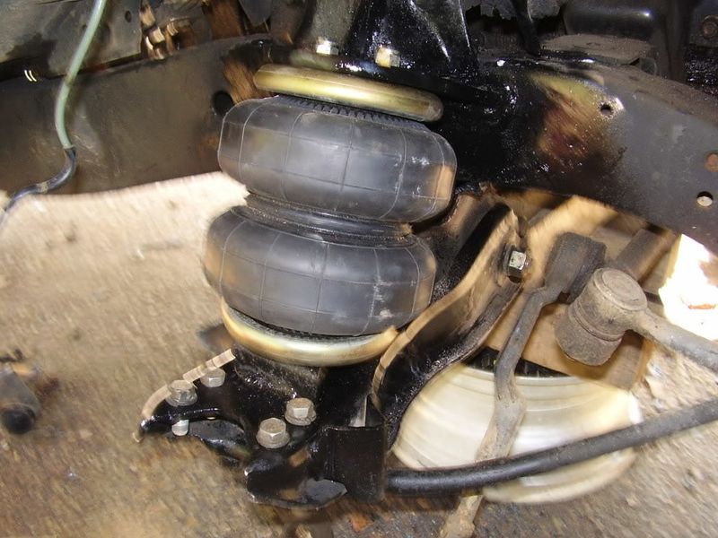

looking good to me so far.. you ading gussets soon to the top? the top just tacked so far? oh yeah might tilt the top plate up a little if i remember correctly...lol

looks good to me, placement and all so far. post pics of it after its gusseted and all too, nice though!

yea tilt that upper bracket up little bit, and after you gusset the top, gusset the bottom
other than that, you doing good

thanx guys that was quick.yeah im gonna angle the top back a little and then gusset it.i made an oldskool 2 link in tha back for now but later im gonna do a reverse 4 link.oh yeah its gonna be pretty fast...i got some 5/8 id goodyear line with 1/2 inch fill valves,and 3/4 dumps...i know its a little overboard but thats all i have at the time...all that stuff came off my cavy.needless to say i've been around the bag stuff since 2000(hoppncavy)at streetsourcemag if you wanna
