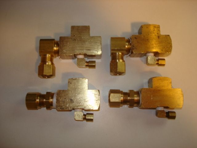

First of all depending how your valves are assembled, youd have to tap into or branch off of the assembly AFTER your fill valve.
Lets say you used a brass T.. instead of using reducers and branching off, possibly slowing down your speed.. try to find someone to drill and tap the brass T for a 1/8" NPT fitting. you can even pick up the tap at lowes for like $5.
Then you basically run small line, 1/8" from each of those Ts to each of your gauges fittings.
Here's an example of the fittings added to the Ts I use:
Hope that helps some, also.. if your gauge is anything like the ones I usually use.. itll be a pain in the ass wrapping teflon tape.. I found it easier to use liquid teflon for those small fittings on the back of the gauges. the mounting screws/light fixtures got in my way. let me know if you need help with getting the line/fittings.
Good luck man

i am probably going to put them where the factory heater knobs are for now, the only problem that i see with the tapping in the gauges is that i have a non copper fitting for my valves, basically it is the dump on the top, going in to the t fitting with the line going out the side and the fill on the bottom so how would i go about doing that?
whynotfab's avatar
whynotfab
do you mean non brass? if so what type of metal is it? i think you can still tap into it either way.. people tap steel, so the softer materials used in fittings.. brass, galvanized, etc is pretty easy. as for the actual way you have them connected to the T, could you draw a pic in paint maybe lol.. or take a pic if possible?

the 2nd is how i do my valves, but the T can be turned in different ways, is yours like the first crappy drawing? haha
drpdmazda
yeah i meant non brass, dont mind me a bit tired, the drawing you made up is pretty much exactly what mine looks like, that is a big help, i really appreciate it man, if you ever need help in the stereo department or any kind of electrical wiring dont hesitate to hook me up, cause in my eyes what goes around comes around so i owe you a favor
thanks again man
