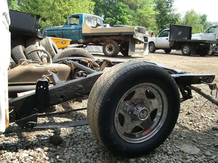

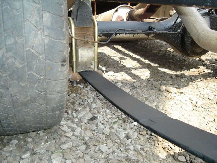

Dropped them other three leafs. Looks good so far, Need to get the bed back on to really see how it went.
mark
cool, how much suspension travel u got left? seems like u still got some in that pic cause the bumpstop isnt ihitting the frameit looks like
thetornado's avatar
thetornado
theres at least an inch between that bumpstop and the frame. not really sure how much weight it will be able to hold yet...

how do you D-arach your leafs? and what does that do?
2fine89's avatar
2fine89
A spring shop takes your sring pack apart, and 1 by 1 they use a press to take the spring out of your leaf. just think about taking the arch out and straightening them.
thetornado's avatar
thetornado
so how much more drop does that provide you with?
