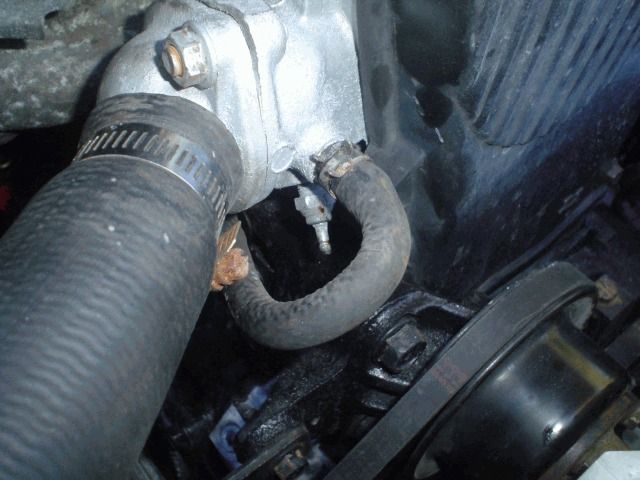

hey zac look under the water neck and you will see it. there is your rad hose out the side and a small hose out the side. the sensor is right under it with one single yellow wire. i just snapped a pic if you want it give me your email and ill email it my photobucket is busy loading pics already.

here you go
brokentoyz's avatar
brokentoyz
if your guage pegs out past hot when the yellow wire is not connected then the yellow wire is grounding out somewhere

Ok so lets see, I had seen that sensor before and wondered what it was but where is this yellow wire supposed to be going off of it?
The only sensor I can see with a yellow wire is the one on the side of the block. And I am pretty sure this controls the temperature gauge. Now there are two yellow wires with red bands in that area. There is a very short one that I believe is for the sensor and a longer one for the alternator. By length they can both more or less reach each spot. So I tried swapping them and this time the gauge went down to nothing. So now I am wondering, the short wire reads very hot and the long wire reads cold. Which is the right wire? Any other ideas? Could the sensor be shot?
Heres some pics because I like to be able to see things lmao. In the last one you can see the sensor with the short wire connected and the other wire running past it both with the same color insulation.

second pic is the oil sending unit

So then what controls the gauge? And why is the gauge effected when I take the wire off of that?

what does it do when you pull that and does your oil light come on
