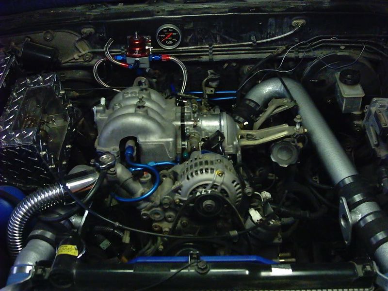

Apex seals are'nt always what goes out in a rotary, although that depends on what kind of life it had unless it's been rebuilt. Now when a apex seal does go out it sometimes/usually beats up the rotor and housing, or just totals out the two. And here's my engine bay
'87 tII full wiring swap out of car
