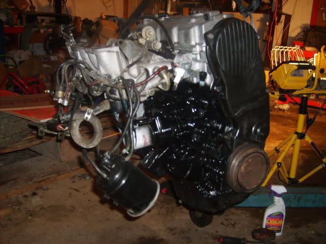

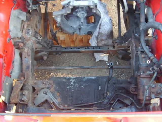

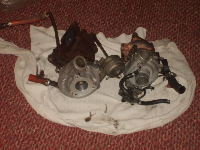

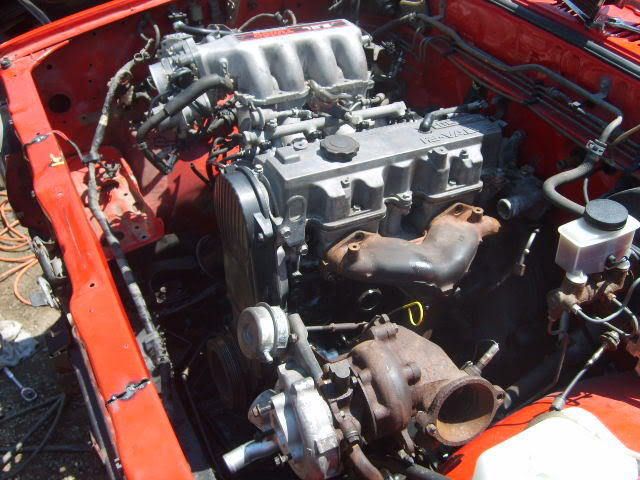

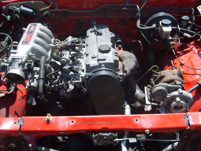

More progress pics its coming along...

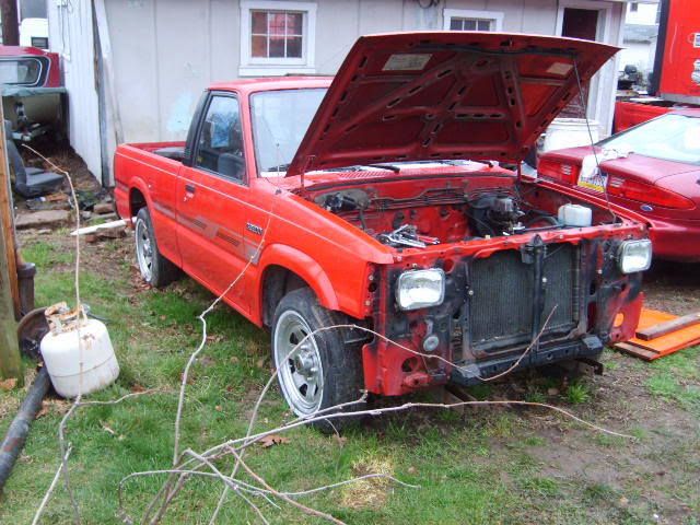

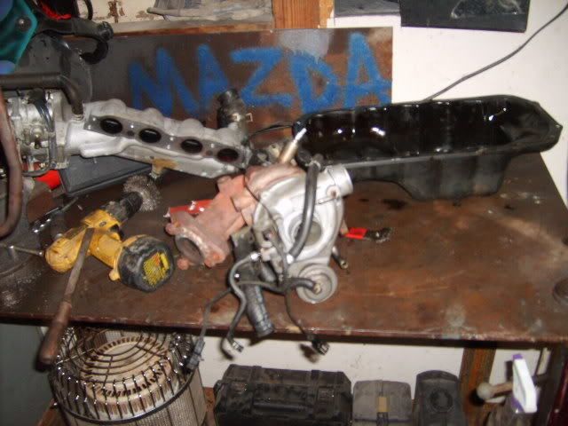

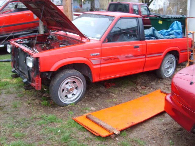

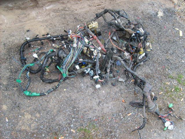

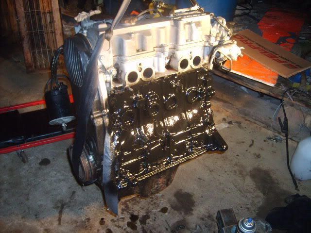

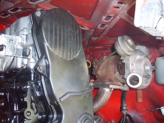

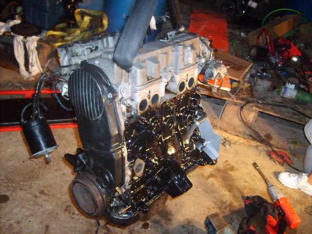

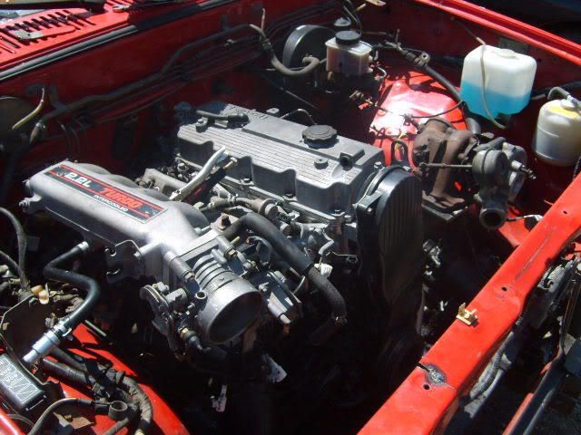

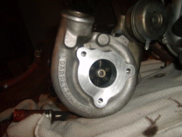

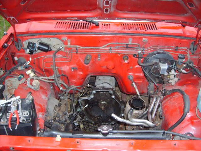

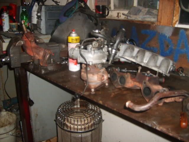

Motor and tranny mounts have all been moved forward 3/4", from have of the frame has been painted, removed the powersteering, got the turbo flip pipe built and mounted, still workin on the intake flip mount, got some small stuff to stick back in it like the rad, mx6 throttle cable, hook up the b2200 harness to the tranny, For the motor i decided to make it hard on myself and go with Ford edis dizzyless ignition system and megasquirt II stand alone fuel management...

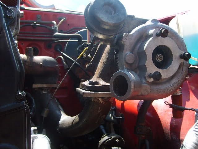

Thanks guys im tryin to get everything mocked up, im working on the air filter mounting and piping for the turbo and the 3" downpipe right now, should be ordering the front mount intercooler and piping this week, then once eveythings together, except for the wiring, im gonna send alot of it out for powder coat...I'll keep posting pics as it progress's..

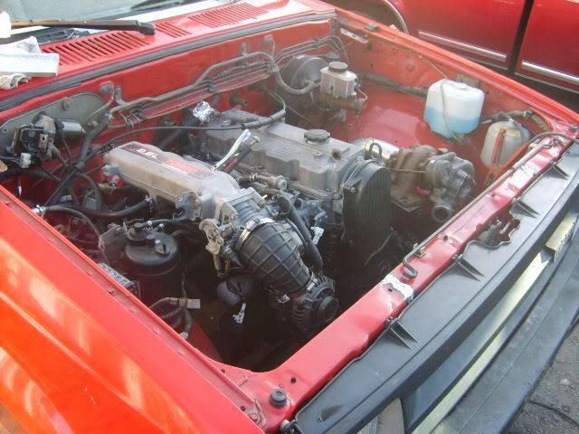

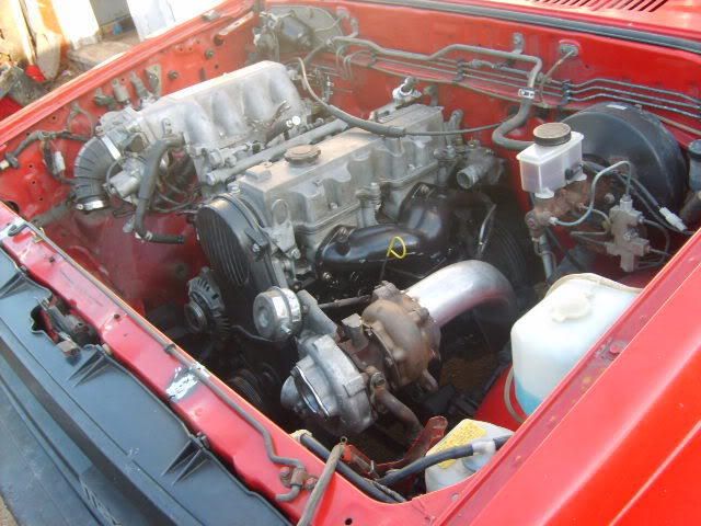

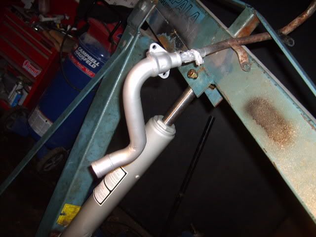

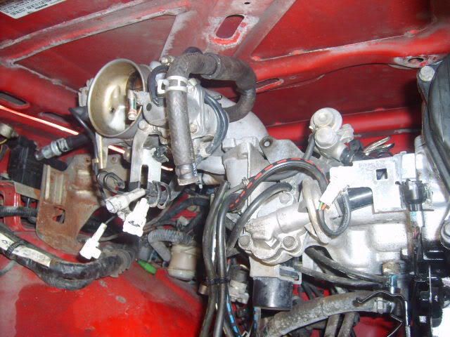

Ok, so i got alittle work done to it, i will be putting the rad in tomarrow, and a bunch of other little stuff its coming together. Just thought i'd post up a couple pics i've been building a 3" downpipe for it then the exhaust will be 2 1/2" the rest of the way. In the pic i just have the downpipe tacked on it will be wrapped in exhaust wrap to keep the temp down...
