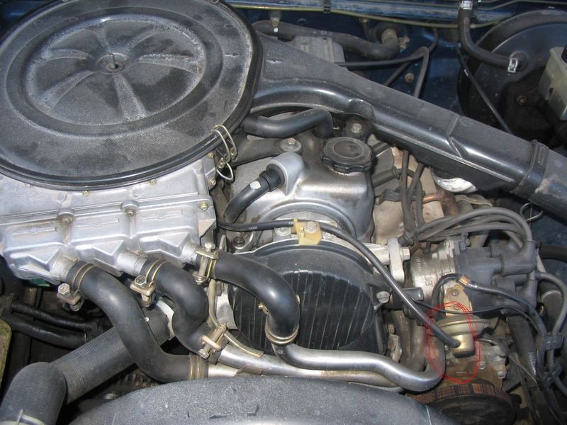

well there is definatley no vacuum coming out of the line that goes to the distributor...i attached a picture and the line highlighted in red ....when i take that off it doesnt change the way it runs and there is no suction .....so i guess i will have to look for a vacuum leak.....althought i did just quiclkly run a torch around the carb to see if i found a spot where it changed and i didnt find anything but i will keep looking
