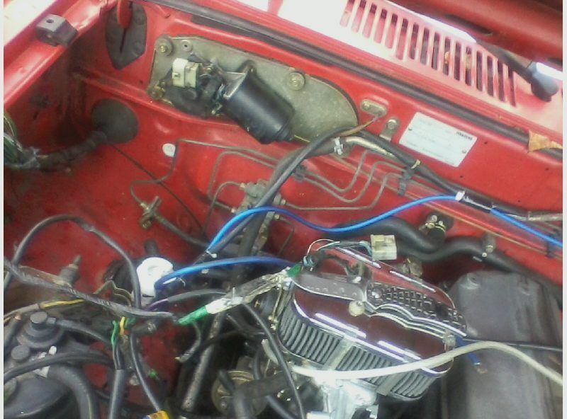

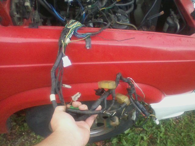

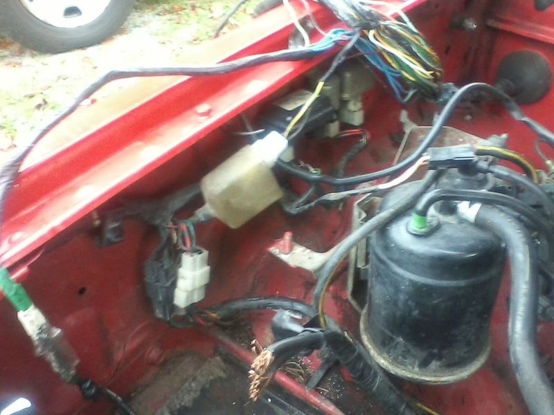

Apologies for the long post ahead of time, and if missed something or did it wrong let me know. I know that as of right now i did mess up the wire leading for my rever lights and the clutch must be engaged to start wire lol sorry idk tech terms for it. But this is an easy fix I know which wire it is. Now Merciless had said the wiper motor " bundle " goes to it's own harness if i read it correct, but if there are the blue wires on the computer hookups, just in case i'm going to push them out as Dan offered.
Now for he pictures, as i mentioned i got rained out, tomorrow is my birthday woohoo 25 lol. but it will be spent doing what i haven't been able to in over 4 years of not owning a vehicle. drinking a few and finishing this up.
Ok in this picture the connected wire with the large rubber grommet? around it leads into the computer bundle just making sure it isn't anything important. maybe to me just seems like it would be the connector from the ignition which turned on the computer?
Obviously this next picture is the bundle all wires etc , can i just snip all the unneeded connectors on this end?
Now, in the top left had corner is the gasket i need to cut to allow the wiper motor connection to come through. Could i use a silicone to reseal it if i get a clean enough cut? Also i'll be re routing my amp wire through this hole, probably get me some extra 8 gauge wire as well in the process.
