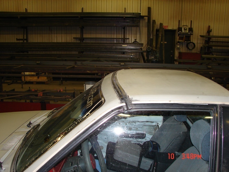

snoplow
see where the black part is on the roof? where that comes down and meets with the window, thats where it leaks. this is about as good of a pic that i have right now, short of going out in the freeking cold and pulling the cover off and taking a new pic.

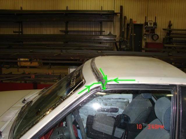

thanks for putting up that pic, i added some arrows to better explain
when the truck is still, the water runs along the bow and along the drip rail over the bow into that hole. if you can eliminate gravity, you can fix that.
when your driving, it runs up the drip rail and into that same hole between the bows.
hope that helps

Yes thank you for posting that.
Is that the only Place it leaks?
How did you combat the top window rail? does it attach to the removable top or snap back in the Orig door frame?
