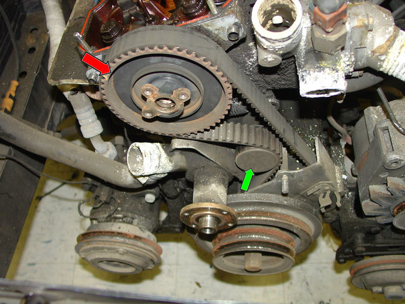

heres a pic, not my pic, just a tensioner and belt and 2 gears, cam gear and a gear on the back of the crank (kinda hard to see it in this pic)
these motors are interfearence motors so if the belt did or does go there will be damage to the valves or pistons, but again used or new parts arent that bad.

its as easy as removing 2 or 3 distributor cap screws, removing the cap and you will see the belt
