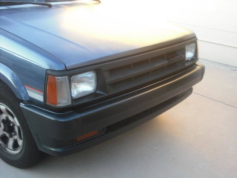

My '86 has a peeling front bumper coating. I'm sure it'll come of with a rough scotch type pad or sandpaper.
But what is it that I buy to recoat. Seems vinyl-y, or rubberized?
Also the frame around the back slider is black but worn off in places. It's a very thin paint? I guess it doesn't really matter on an oldy but original would be nice.

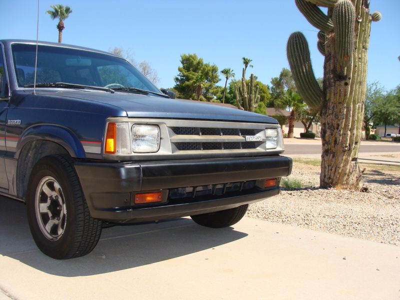

I painted my bumper, bumper ends and lower grille a few months ago. I used Krylon Fusion (made to adhere to plastics), no primer or sanding.
So while contemplating getting a black upper grille for mine, last Saturday I decided on a whim to paint the upper grille the same way. I had decided to make the headlight surrounds black. It seems to me - from looking at the underside- that the grille was originally a dark gray.
I painted the letters over with a brush, some automotive touch-up paint will work, those come with a small brush.

Thanks Dan W. I have to sand off what ever's there because it's kinda looks like skin after a bad sunburn, all peeling and yuck.
Nice looking truck Cusser. I hope my front end looks that clean when I'm done.
