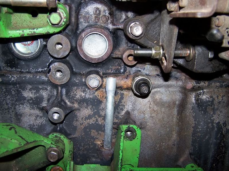

The oil and coolant temp gauges came with adaptors, on the stock carb intake there is a fitting that uses NPT, should bolt right in easy, for my diesel intake I had to tap a pre-existing hole to be larger. EFI heads should have the same access point that the carb heads do, it is a square plug that can be removed with a (I think) 13mm box wrench. Oil pressure gauge there should be a 2nd point on the block near the oil dipstick tube you can tap into. For my diesel setup (turbo) I had to implement a tee for my gauge at the stock oil pressure sensor (as I needed the extra port for the turbo.)
Your stock block should look **similar** to this here:
