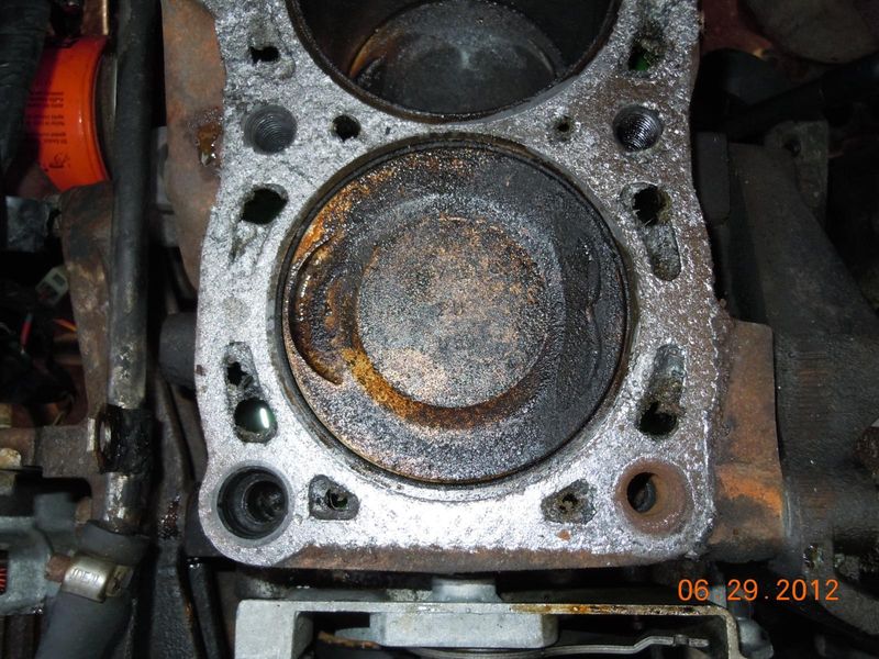

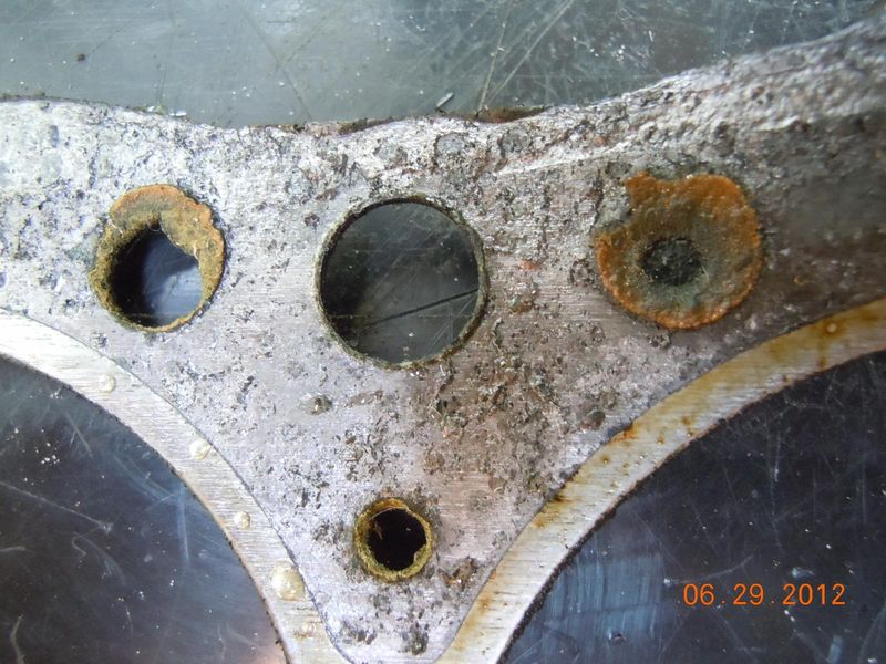

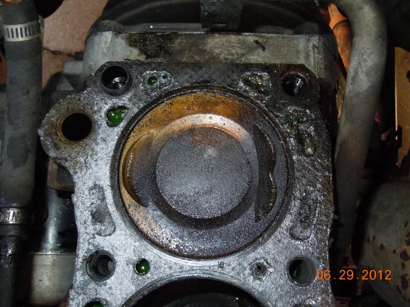

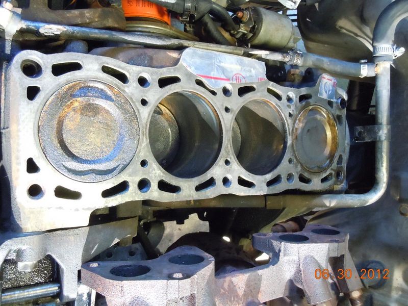

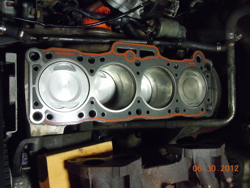

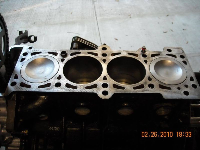

does anyone know where i can get a block from for a b2600i i think mjnes warped i put my motor back together with all new gaskets plugs wires etc. when i started it after about 7 mins of idleing the truck smokes like a freight train blueish white smoke so i thought it was the rings done a compression test they were all at 150 the number 3 plug was caked in oil so i pulled the head back off and around the gasket on top and bottom was oily and watery so im guessing my block is warped does anyone know anything about this thanks
axel breaker earl's avatar
axel breaker earl

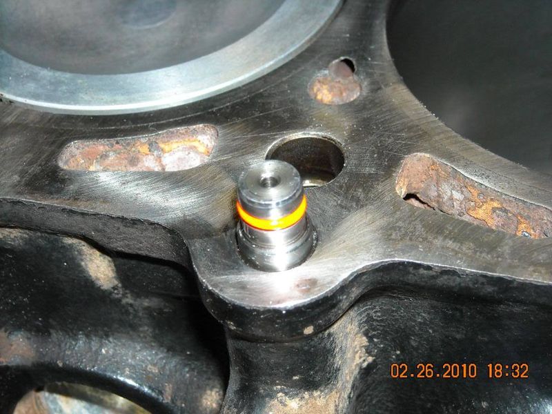

Did you put a new O-ring on the nipple that supplies oil to the head/valvetrain?
If not, you could be getting oil seaping into the #3 cylinder.
