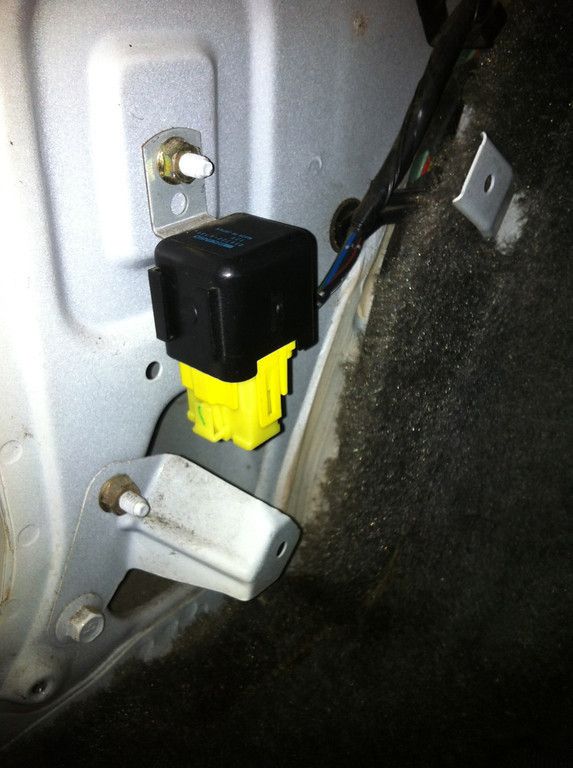

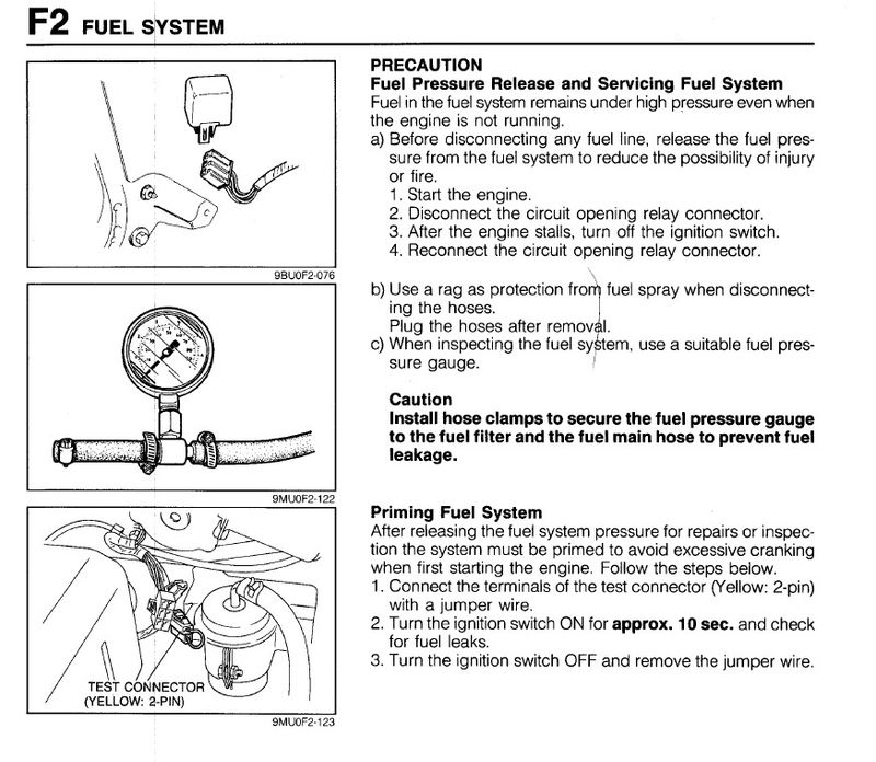

Before you get started, if you are not familiar with depressurizing the system, you can do it by starting the truck, and then pulling the Fuel Pump relay (aka "circuit opening relay") located behind the driver's side kick panel. It will take several seconds to die. Here are the steps for releasing and re-priming fuel pressure along with a pic of it's location:

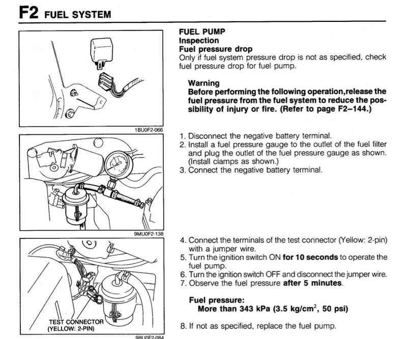

Here is the basic pressure drop test....
Here is Pump Pressure Drop

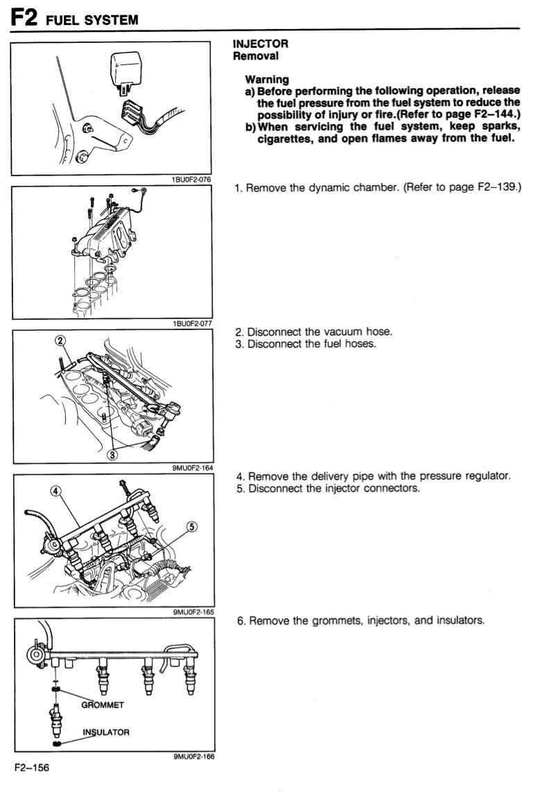

Injectors
If you end up going this far and pull the injectors, it would be a good idea to replace the o-rings and seals if they haven't been done in a while or ever. Might also be a good idea to send the injectors out for cleaning and they will come back with new seals, o-rings, grommets.

Before you open the fuel system up to start checking it, here is a real simple to test to confirm that it is the fuel pressure bleeding down. When you get ready to leave in the morning (and the truck is cold soaked), before you start it, jumper the yellow fuel pump test connecter and then turn the key on for 10 seconds to prime the system as described on the first page. If it starts right up, then you have reasonably confirmed that fuel pressure bleed down is causing the problem. If priming it doesn't help it start quicker, then you might have something else going on.
