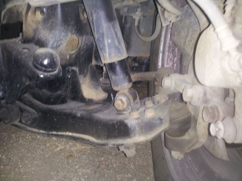

Well I was just wondering if my situation is safe to drive on: my truck as it sits right now has no bumpstops and the torsions are cranked about as far as they can be. So there it is I'm also running stock shocks for now but hopefully that'll change soon. And no I'm not rubbing Tire into fender I can turn full lock with no rub but I just want everybody's opinions and stuff being that I have to drive it and I have a 60 mile commute. Thanks as always

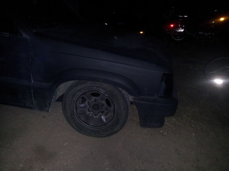

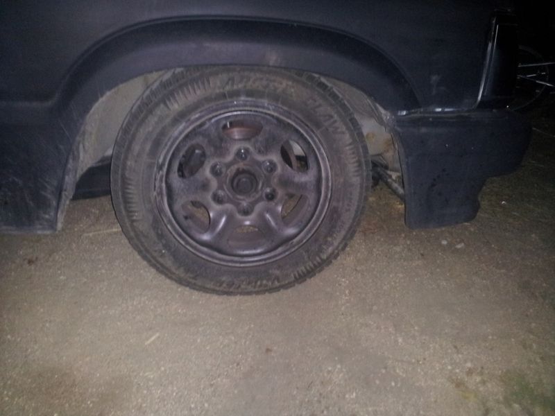

Okay thanks guys as for jkill here's a couple of pics and sorry they're a lil dark!

Almost forgot on those short bumps will they even fit? Look at pic number 2 and you'll see its only got like an inch or so or clearance. Thanks as always.

Your shocks are most likely gonna be bottomed out, not a comfortable ride, and when you get shorter shocks you'll rub tire into inner fender then.

I would crank torsions up one or two and then due the ball joint flip

I'd also cut out the factory bump stop mounts. I removed them in the 3 mazdas I've owned, and 2 of my buddy's trucks that we lowered. Smashing lca into that steel mount aint fun either...
