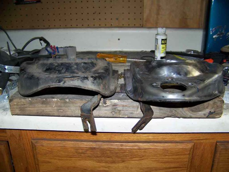

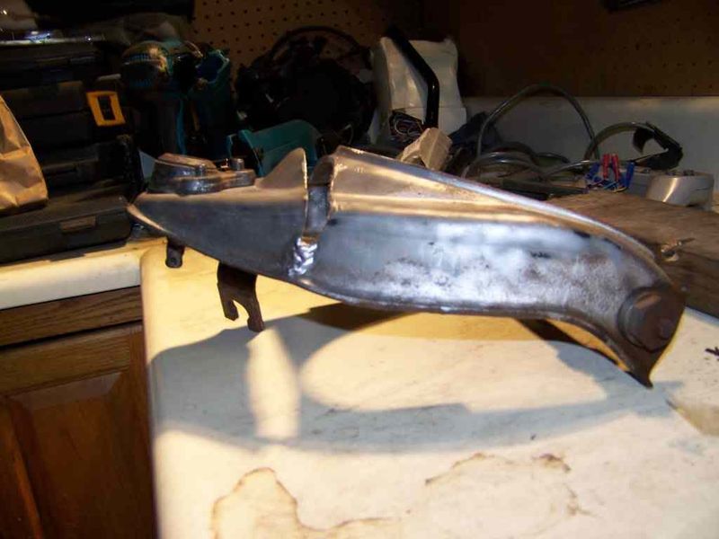

Here is a pic of my UCA's that I pie cut.
STOCK ON LEFT AND PIE CUT ON THE RIGHT. It wound up being about 15 degree's different. But that will change with each application.
I cut mine from the top. Some people cut them from the bottom.
