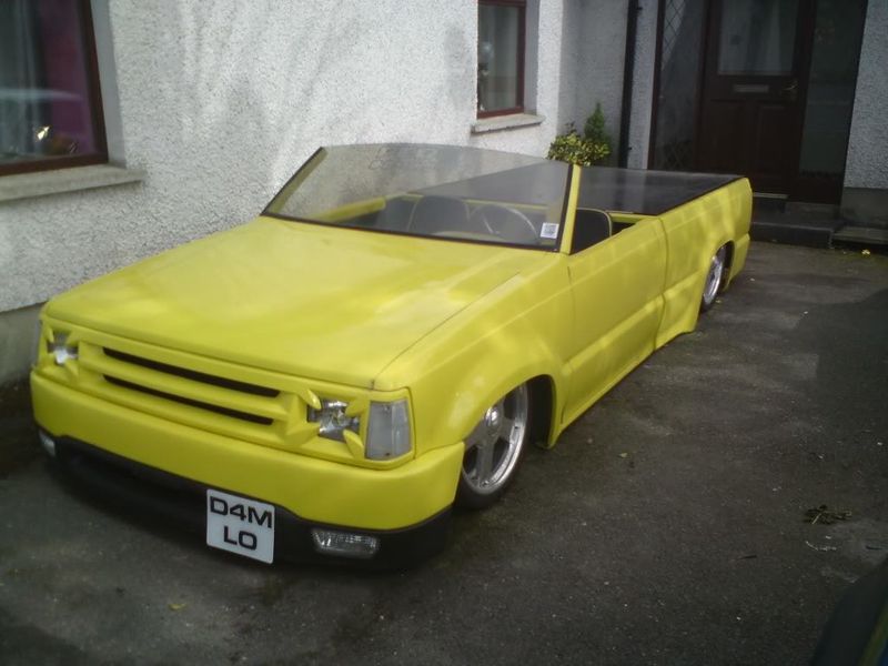

thanks for the replys guys! thought as much but i thought id ask as theres a fair few more rangers about here. yes, northern ireland actualy. i bought this convertable shortbed out of california and had it shipped across, but it has some crazy 2 link in it with cylinders, loads of lift and still cant get over anything, it was never going to see the road with our laws over here...
i painted it yellow when i got it, but thats as far as i got, bad picture...

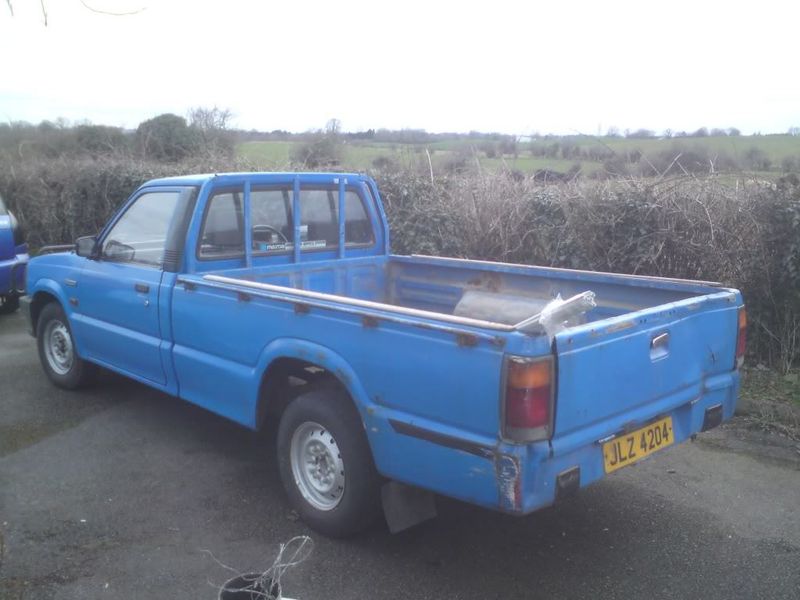

and ive now broke it up for the 4x4 metalwork, wheels and air, to put into this, which has a roof (particularly useful over here).
plan is to use the shortbed front chassis and make a good clean longbead one out of it, drop the tatty blue body over it, and maybe turn it into a widebody longbed at a later stage.
