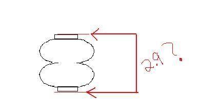

Im getting the RE7 for the rear of the truck , and when looking at the specs on them it says that the min, height is 2.9 inches..... is that from the top of the top bracket to the the bottom of the bottom bracket?? just want to make sure before i weld my bag brackets in and I'm wrong...
its a bad pic but it gets the point across

it should be the overall height fully squished from bracket to bracket cus thats what i have on my bed

Yes your picture is right. The bag is 2.9 inches fully compressed.
