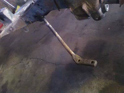

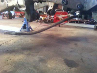

here's a couple pics of the part I'm looking at just so everyone is on the same page lol ....

its where you take that part off cuz you wont need it and you weld a bar from your arm backside to your frame making sure you put it at the same pivit pount were the arm pivits, i put mine 8 inchs away from the arms mount so it worked out good,......,. your makeing an a-arm out of your arms... look on here i thank theres a thread on here about it maybe if not i'll get you some pics of mine
is where it comes off the arm i got right now but you can see kinda what im talkin about
