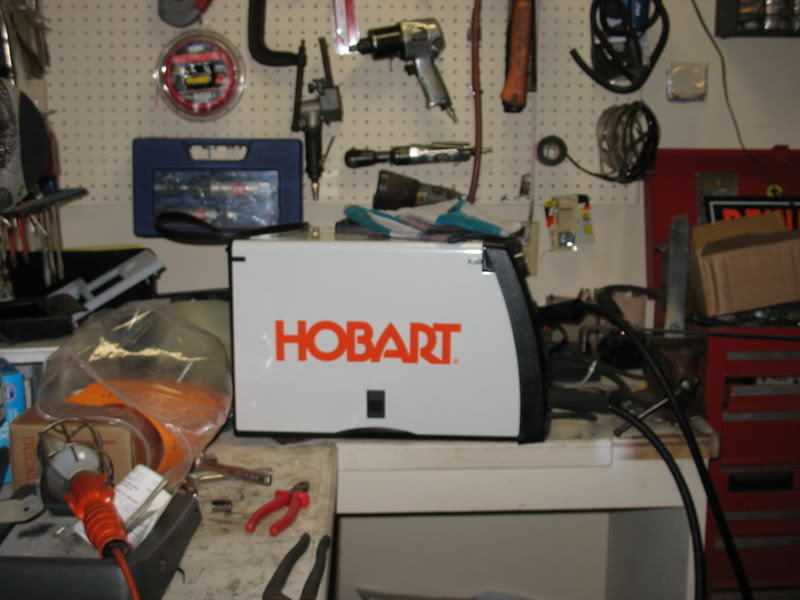

I just have a little Hobart 125 with gas i picked up locally. It's been great for body work but i don't think i will be able to use it to weld my 4 link tabs etc. You guys ever weld 1/4" suspension components with a 125 successfully? My welder has worked properly for the past year i have owned it besides having to get the gas valve relay on the board replaced.

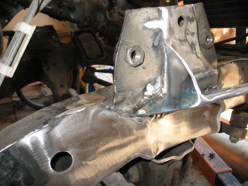

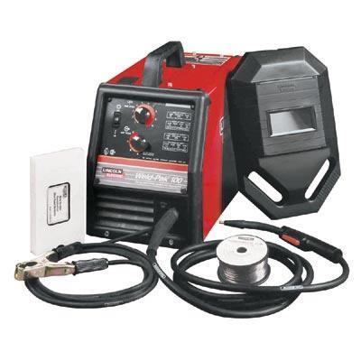

I've got the lincoln 100 amp and it welds thick metal just fine, but I use hobart ".035 flux wire in it for any thing heavier than 1/8" I've welded 1/2" D-ring tabs onto a couple of off road bumpers with it and they hold up to that abuse. as long as it's a good brand and you have a decent knowledge of welding you can pull it off with out issue
sleepyspeed's avatar
sleepyspeed

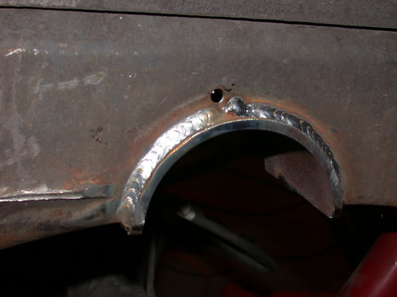

if you look closely you can see the heat lines in the metal so mine burns into 1/4" just fine, plus if you play with wire speed and slow down you can burn in more. Grab some spar 1/4" and get a idea about what you want your welder dialed into to penetrate

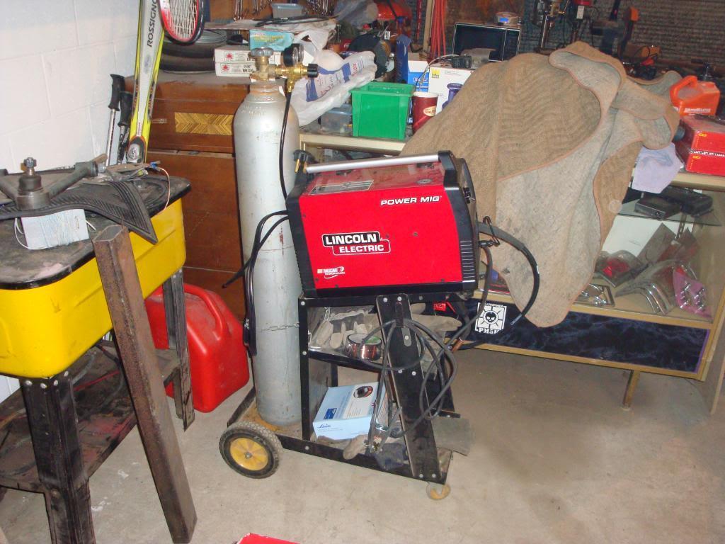

Lincoln 220HD. Welded my 1/4" just fine. .035 with 75%/25% gas. Welds so nice.

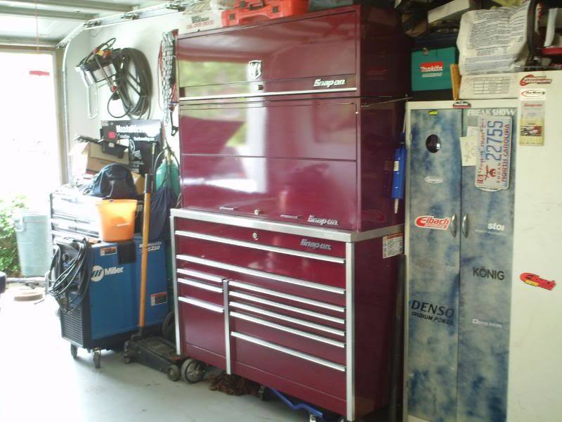

I run an older miller 175 220v mig and a miller 250dx tig. But if your going to use that 110 hobart for your suspension I would use some .030 wire so it wont take so much juice just to melt the wire. I use .030 with my 175 on my builds and products.
