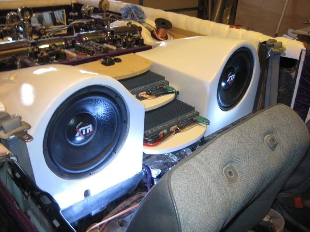

Like Rick stated, you can fab up an upper mount. I did on my roadster and they work great.
Could not find a clearer pic of the mount but with my setup the truck also had a walk thru conversion. The opening in the back of the cab is heavily reinforced so it was a natural place to add the upper seat belt mount.
crazymikey's avatar
crazymikey
Great design Linn. Very simple, but it works
