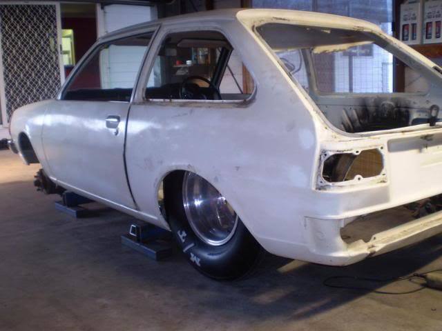

i got a mazda 323/GLC 20bpp in the build 15x12 with 31"x13"slicks & 15x3.5 on the front
another 323/GLC weekend driver with a 13bbp (bridgeport) with injection perfection

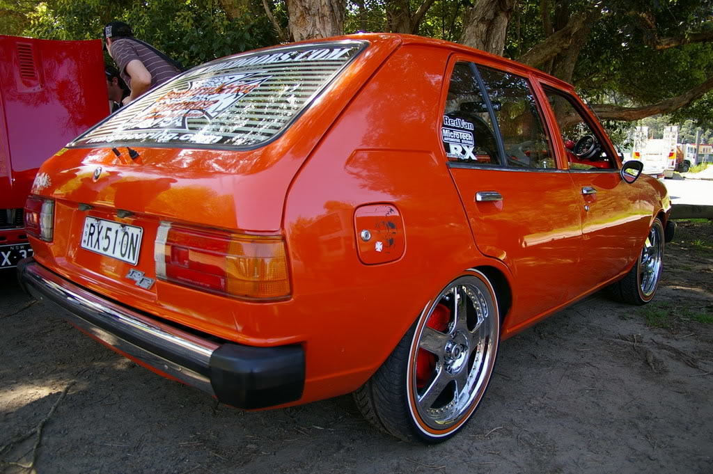

then thers my daily cruiser mazda 808 wags with all us spec grilles trims badges steering wheel etc

heres a new chopshop pic
but itl have whitewalls and a 6 pointcage and lower due to bodydrop & cut the sills off but not doored
