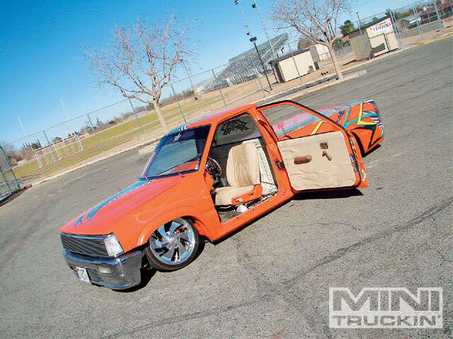

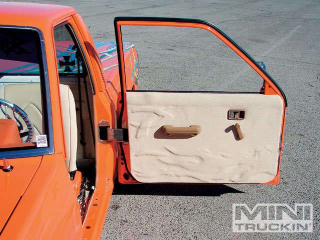

Here are some photos of the end result!!!

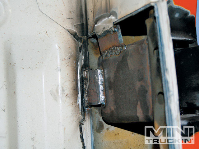

Cool man but the controversy is whether they are a good set or not. Yes i can see they are maid from thicker matterail but will they hold up as long if not longer??
blackesdime
well... that install won't last. It doesn't look reinforced enough. You can make a hinge kit as thick as you want, its NEVER going to make the hinge more effective when you're only welding to 20ga at best... (maybe multi layer 20ga sheet metal). The only way to make that kit work and last for time to come would be to plate the inside of the door jam with 1/8" steel, roughly 6" up and 6" down, etc... Long term, that hing is just going to crack out of the door jam.
However, i don't have any physical evidence with a kit being installed and used for any extend period of time... but if you work with metal, you'll understand the physics of it.

so from those pics your saying it is a bad install, do you know who did it? he has built a "few" nice rides and im sure he did what was required to make it work. also if you look the door is not saging in the pic.

i don't care who built it, i'm judging by pictures. Proof is in the pudding, right?
the rear door jam is NOT designed to support the weight of the door... the front is.

You can see from this picture that he used very thick hinges,box tubing and thicker plate welded to thin mazda sheetmetal
That over time is going to get pressure cracks, leading to door not closing properly possibly. By the time that happens the truck will most likely be rebuilt or in scrapyard.
Is it properly done? somewhat. Those plating inside to original mazda metal isn't much. Doesn't matter if it's 1 inch thick gussets, your still welding to thin sheetmetal. You need to spread the load over a greater distance when you weld to sheetmetal.
What should have been done is 4-5-6 holes drilled on upper side of that square cutout and lower side of that cutout. Then take a 1/8 plate with 3-4 holes drilled over section where the hinge will be located. You then insert into that cutout and plug weld on upper/lower portion and then plug weld the 1/8 plate to the hinge/box tubing. Obviously allowing access to hinge bolt.
