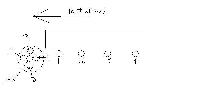

saveacivic
Ok, so just clarifying" at TDC the rotor should point left. That is #1 so that wire should go to the furthest plug to the front of the truck (so front most is #1, then 2,3,4). Then going clockwise on the distributor should be 3,4,2... ???
I'm only making sure b/c autozone.com has it differently, but I have seen them wrong before... Just want to be sure before I crank it up! Thanks again
mazdawg(mikey)'s avatar
mazdawg(mikey)
its crude but itll work
