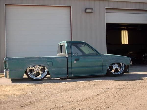

i thought of a irs. but i dont think ill be able to get the lift i need to acheive to untuck. heres a refrence picture of how far the back wheels tuck into the bed.

i know thats not what you want but that shit would be sick.

sorry bro, the pic didn't show up on my end, I see those huge wheels, I'd say that you
might could run a vette rear with some custom upper & lower arms to get the amount of
lift you want...like papa said above, it'd be sick!
