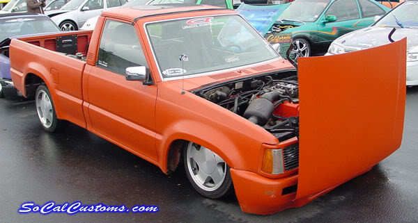

I had a nonturbo 2.3 in one of my old mazdas. It was bitchin. Mine had a BorgWarner T5 out of a mustang, Eventhough the motor mounts didn't bolt up they still lined up. With a little fab work it worked great. The shifter even came through the stock hole. Ialso used the entire wire harness and gauge cluster from the Mustang. My Mazda even had a Ford key.
cidawg(taylor)'s avatar
cidawg(taylor)
you can see the stock mustang intake tube. Unfortunatly this is the only pic of the motor I have.
