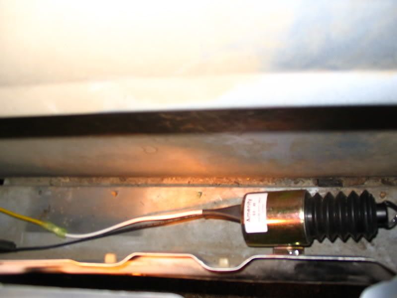

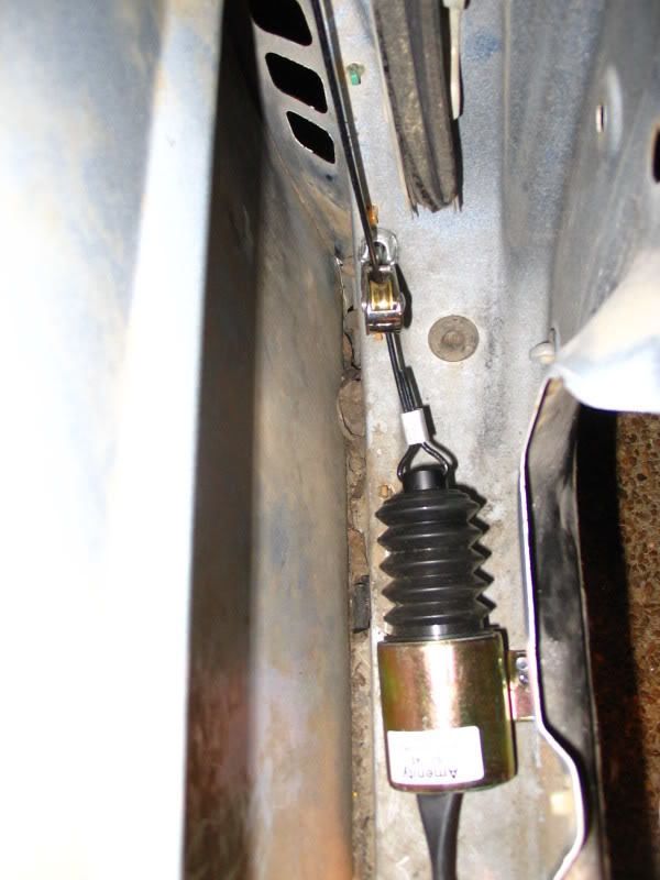

um.... why would you need a hump for the solenoid???
You mount the solenoid INSIDE the door. I mounted mine on the bottom side of the inside of the door and mounted a pulley and ran the cable through the pulley up to the latch.... here's pics. You def do NOT need to redesign door panels jus to have shaved doors....

i didn't feel like foolin with all that haha, the pulley seemed easier to me
